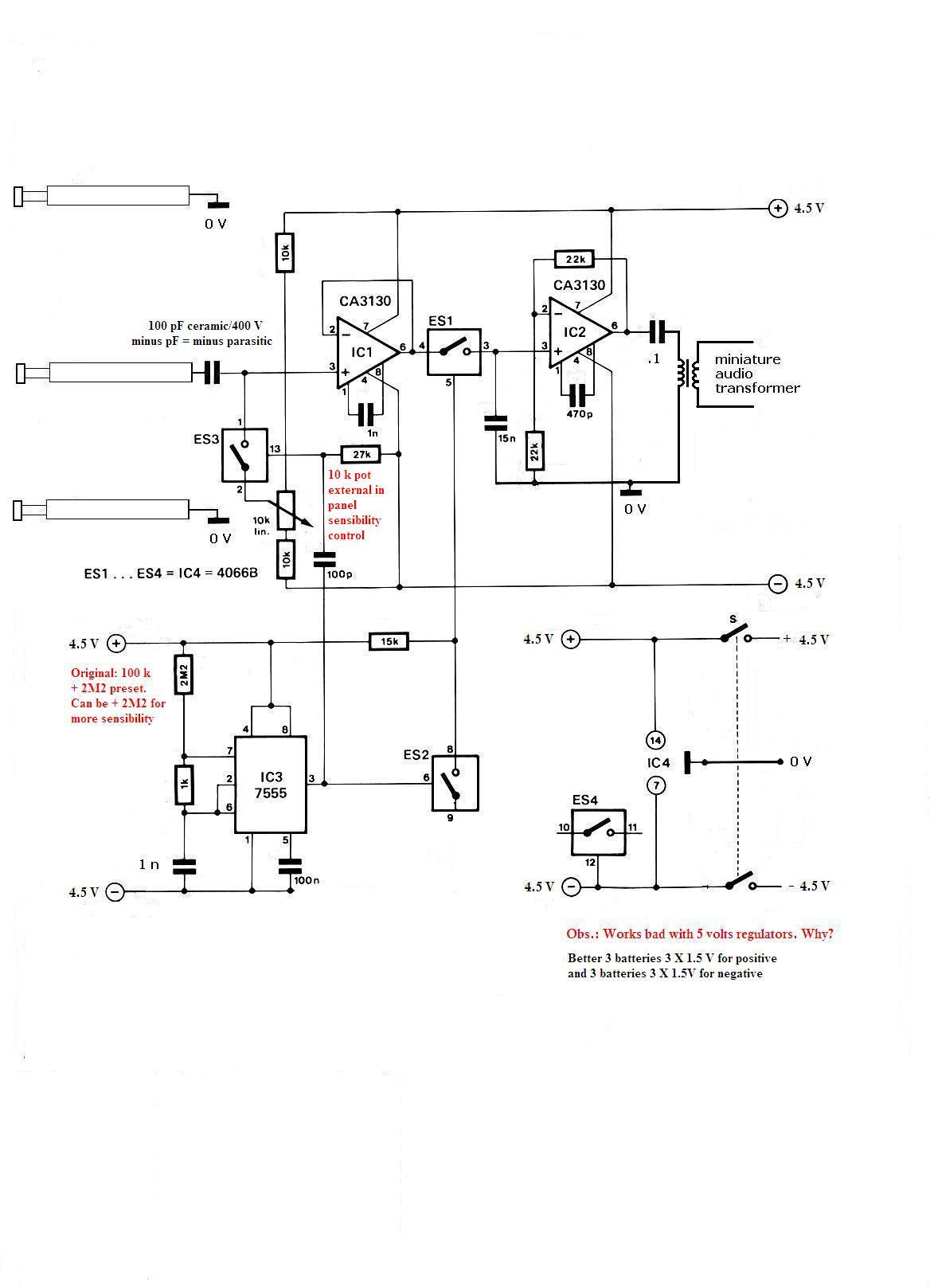

Remember Carlos post only the schematic because three pages is heavy for the forum.
I repost in thread Confused on detecting noble metals at great distances...
http://thunting.com/geotech/forums/s...ghlight=ZAHORI
Read all the thread.

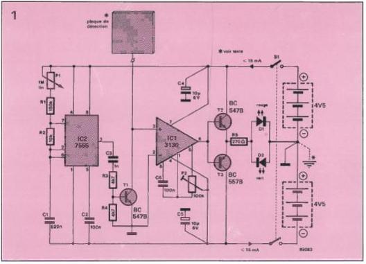

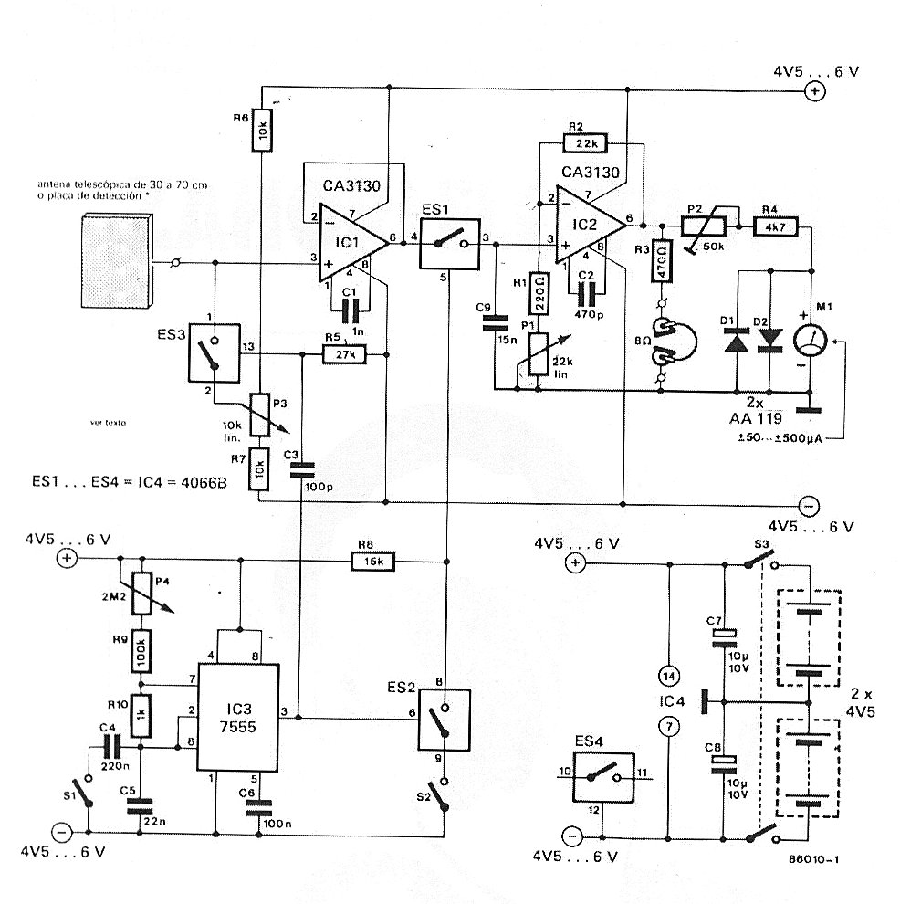

This schematic I have in Spanish, and always claim for the version in English. Maybe, nobody has here. This device was designed for to find water. In this German article (the original is the German magazine Elektor) assume that water in movement below the surface produce ionic interchanging. There are a Russian version about another title, a copy of original Elektor magazine of 1987 in the thread Remote Sensing Diagram:
Original web page http://radiotech.by.ru/Shematic_PCB.../biolokator.htm
(doesn't work?)
Compare the both schematics, are the same! But the Russian has the title "Biolokator".
For to control a pronunciate arrives of ions, the 555 discharge the antenna. The article said that at major oscillation in 555, more sensitive is the device. The 15 nF cap is a kind of "memory", good quality requires here.
No synthetic clothes, no build in plastic.
At the end, the article saids that is possible to detect another type o field, include radiactivity (in theory).
I has done many modification for to convert simple and usable device.
Later modifications.
