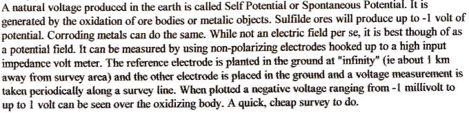

            I consider that the targets buried for long time produces spontaneous potential:
            http://en.wikipedia.org/wiki/Spontaneous_potential
            Max, never I said that the target emmits nanosecond pulses. Just refer need a rapid system for to "assure" the detection: Stretcher in this case.
            Max, you made false interpretation. Max, you're very confussed.
            • If is possible monitoring such variation of voltage and "see" differences between 1 milivolt to 1 volt along 1 km ("infinite"), so I can detect few meters with my detectors.
              • "Battery" into the Earth by metal and ores, etc. Of course, I think that this is the motive why solid good conductive metalic body buried for long time causes MORE REMARCABLE effects.
                          no... I'm not so confused...
                          But you are when talk of 1Km far away detection...
                          In SP measures there's a ground electrode that is connected to ground far from the actual electrode-probe you use to take measures.
                          The fact is that one electrode (the static one) is put into the ground at a very great distance from the place where you take readings.
                          Then the other probe will be in the place where need to read the voltage.
                          Just that. It's not remote , 1Km away detection, the probe you use for reading voltage in a point is just in contact with that point over the soil (or in the borehole in the case of logging).
                          The measure of SP this way have nothing to do with remote sensing.
                          If you mean instead that you can read small potential changes by electrometer, so not touching the soil, but by e.g. electrostatic induction I say it's possible with a sensitive electrometer... I think this is the idea of using zahori circuits: spotting electrostatic anomalies... like a small drop in the potential at a fixed height.
                          Now it's clear ?
