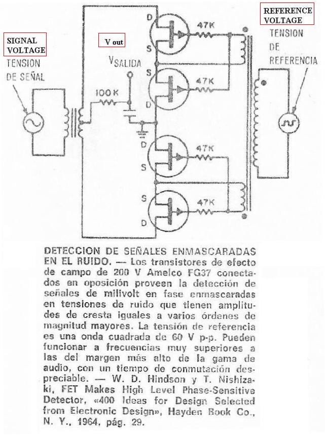

            I wish to made it. Much filters, also poor detection... Saw an old circuit in J. Markus book wich can detect masked signals by noise, and this noise can be more in magnitude than useful signal. This uses a square wave 60 V peak to peak as reference.
                If noise is random,it should cancel itself.You just need to invert one of the outputs ,if you use the opamp idea just reverse it and mix the output , then with both detectors in parallel you should detect nothing, as long as you separate them or point to 90º should begin to see results

                              Fred
                              Maybe, is not good idea to use IC for eliminate noises and also great part of the signal generated by the "phenomenom". Do will better reference voltage in opposition to noise? This circuit claims that can be detected useful signal masked by noises, even if noises are superior in magnitude than signal... This uses a 60 V peak to peak square wave as reference. According the text, can be detectable signal in order of milivolts masked by noises... 1964 circuit and maybe forgotten, but don't know if is useful, but is interesting.
