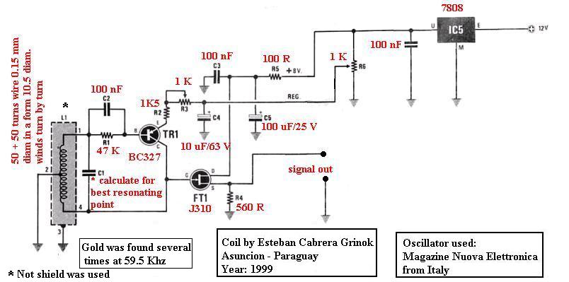

          Do you believe I will post these complete schematics here? They exists.
          This is an oscillator I use for gold detection... with other arrangements.

                Schematic based on HV, 5,000 volts.
                Sorry the small picture...

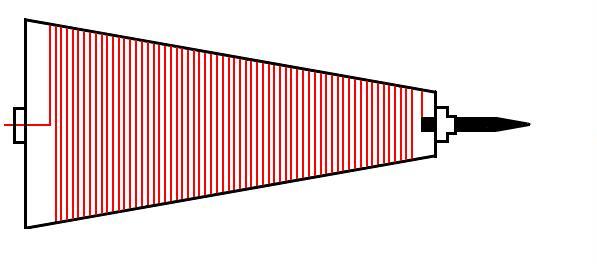

                • #53
                  HV coil for pistol type Tesla

                    Esteban, FANTASTIC, NOW I will make this and see what happens. Can you give me some pointers on how to use it please? I am NOT going to pooh, pooh your schematics or ideas unti lI have proved to myself.
                    I REALLY want to try this stuff for myself!!
                        So you are saying I could use this to "amplify" the voltage from a target object into one sufficient to measure on a Digital Voltage Meter? I think that is what you mean, yes? That would make sense.
                        But wouldn't that signal have to be AC in nature for the transformer to work? How does this signal get to be AC and what frequency might it be at please? Unless you yourself "chop" the incoming signal using a signal generator of some sort. Am I getting warm because I can see that there is some practical theory in this approach? If this is the case, then Hung, you are right, I should read more on the subject (No I am not a convert yet)

                                It's no trade secret I guess, unless there is something to hide. I gave you a possible explanation of the Tesla Probe and now you hit reverse gear and run away? Dude I was TELLING you how in REAL terms this thing may actually WORK!! Did you see it as some attack on your pseudo scientific explanation as that was NOT the way I intended it.
                                Looking at the probe I'm thinking of a way to detect anomalies in the surrounding voltage field of possible targets. If you chop the input to the primary at say 59KHz (I think you said that was a Gold frequency) then have a narrow band filter on the secondary, you could monitor the AVERAGE field and look for slight changes. This may work as a detection method, but it is NOT psuedo science, this is hard physical. An Electronics Engineer would be able ot make such a device in a few hours.
