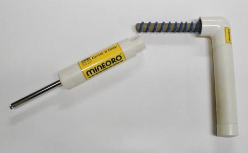

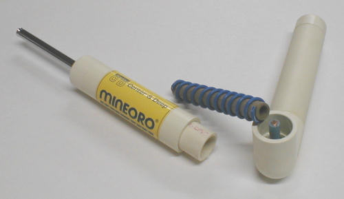

      When Dell asked for internal photos of the PDC, I completely forgot about the "Center and Deep" accessory that came with it. It is a dowsing rod. Nothing more. Inside, there is a wood dowel with a piece of wire spiral-wrapped around it. This wire is not connected to anything.
      In my opinion, this confirms that the Mineoro units are a fraud. If they did work as claimed, then there would be no need to include bogus nonsense like a dowsing rod.
