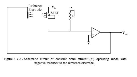

Goldfinder
Detection of ions (molecules in movement) can be selected. Ionic selective detection is a reality and today exist special fets called ISFETS wich detects ions and substances. In accord to Scientific American:
The R&D effort started in late 2001, when Koehl, an electrical engineer, arrived at Cambridge from the California Institute of Technology. "From the beginning, I had the idea to create a small, cheap chemical detection system for the military and Homeland Security and then, later, for commercial markets," Koehl says. He soon met Boyle and Ruiz-Alonso, and during the next months, the engineers looked at a lot of sensor technologies, "trying to evaluate what we could take to the next level," Boyle reports.
A chemical sensor "is essentially a filter device," Boyle explains. "Each substance has its own signature smell or fingerprint. That's what we filter out." For Owlstone's sensor, the team chose to develop a relatively new and little known analytic technique called high-field asymmetric waveform ion mobility spectrometry (or FAIMS). The approach sorts compounds according to how their charged forms--chemical ions--move through a gas when subjected to electric fields.
As the ions are made to pass between charged metal plates, varying electric fields (that is, the asymmetric waveforms) drive them toward either side and back again successively, eventually causing most of the ions to hit the plates. But careful application of direct-current voltages to the plates keeps targeted molecules from hitting the sides until they reach a detector at the end. Each DC voltage correlates to an ion type, so the device can be "tuned" to detect specific substances.
More info here:
http://www.sciam.com/article.cfm?art...6883414B7F0000
