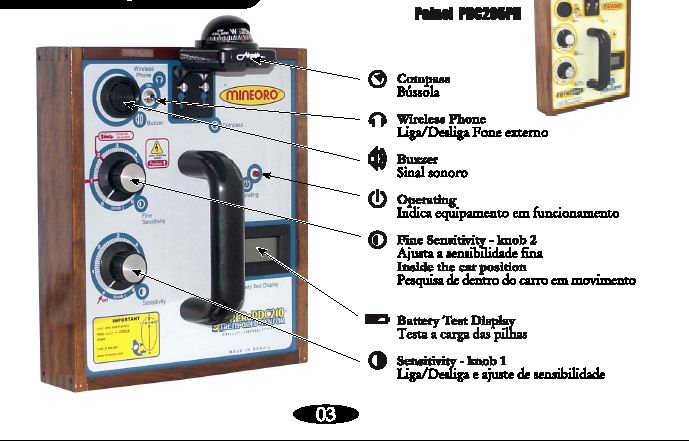

            The "dissected" is the microcontroller version with an only potentiometer.
            The PDC 205 and PDC 210 with two potentiometers that works in the limit is extremely sensitive. VERY. I agree the microcontroller/semiautomatic version (early PDC) is not good...
            I don't know the performance of the 428 (in Dell's hand).
            In this photo you can see the both knobs.
            So, Carl's report is about the early microcontroller 1 knob model (several years out of the market).
