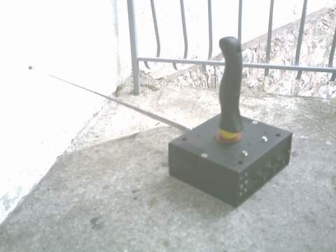

          • #50
            "Crack"hori....
            Regarding to previous posts here on Zahori subject,also on Robert's,mine and
            somebody's elses doubts, i decided to build it and test it. Although,i do not
            beleive in such apparatus like Zahori,Mineoro etc. I simply could not continue
            to talk here,maybe argue with some people here, without any practical experience
            on that subject.So it is quite normal first to build it and test it and than to
            switch on retorics. So, here is some of my notes on this Zahori subject:

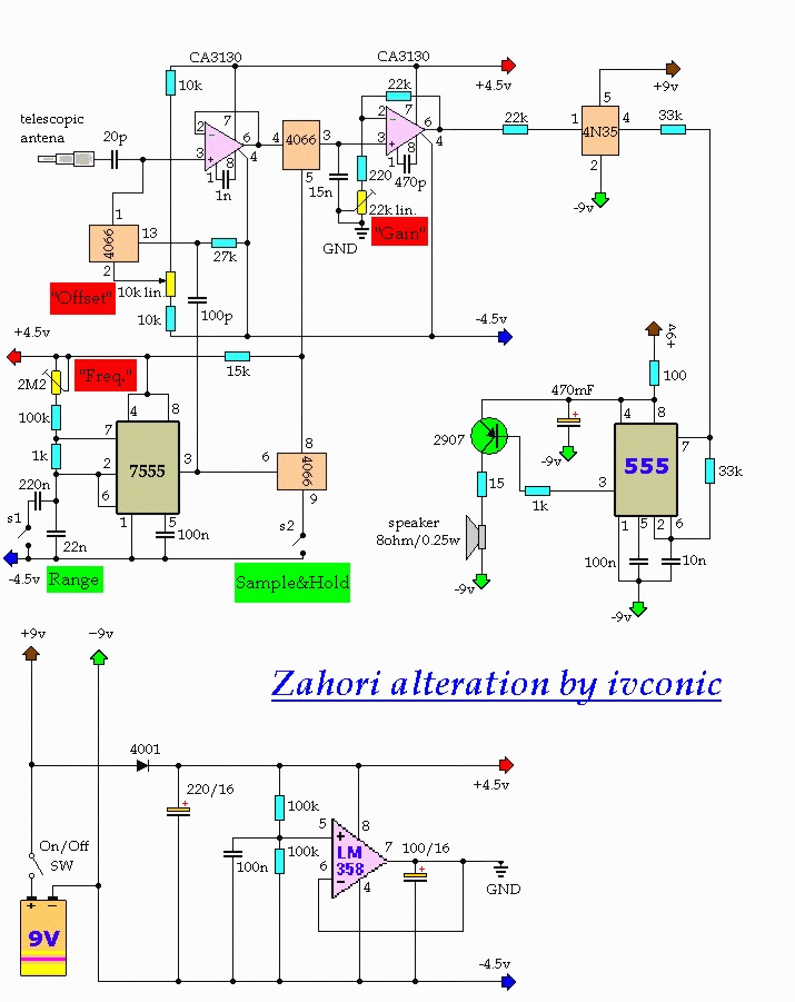

            First of all,i did'nt like idea on using 6x1.5v batt.'s at all. I changed that part
            of schematic as follows on posted picture bellow. I respected Esteban's opinion
            on not to use voltage regulators of 78xx type. Why Zahori refuses to act normal
            when operating on that kind of power supply, i realy don't know, i never tested it
            anyway.But using some op-amp to generate symetrical power supply from one 9V batt.
            is more than good solution, it showed in many designs so far. So this supposed to be
            only evasion from original schematic posted here.
            So when i finished, packed it in a suitable box.On the front panel there are 3
            potentiometers: "volume","sens" and "freq." As well as 2 operational switches and one
            ON/OFF switch. I omited VU scale,respecting Esteban's hint too.
            When switched ON, you can hear sound,loud and clear.When adjusting those pots. a
            lot of strange sounds came out of apparatus.In some positions of pots. you can
            acquire apparatus to stop "yelling". On the very edge of "crack and click" from the
            speaker, when turning around,with antena pointing in some power source there is a
            noticeable rising in tone and much louder "click" become "beep" and even "bleeep".
            So there some "detection" IS going on for sure! When sight it to TV set,is detecting
            it very noticeable even from the 6 meters distance!!!
            Noticed even,when TV set is switched OFF but remain plugged in the wall socket, is still
            detectable easy! But when tv is unplugged from wall socket, than no detection at all!
            Same situation with all electronic apparatus in my house.
            Step by step i have been tested and checked every situation and condition available on this
            subject. I spent 3 days doing this. So now i am much,much more experienced when talking
            on Zahori stuff. Of course, i did not have possibility to check it on some burried
            treasure, 'cose still do not have any one around my house, but also checked it on my
            test field in the backyard of my home.
            NONE of the items in my test field( over 200 burried items,various depths,various
            materials,various sizes and various time in gnd.-from 1 to 10 years as burried)
            WAS DETECTED with this Zahori !!! Neither one detected item!!!
            The very same situation and results as with my ionic detector!
            I also noticed one very important thing! AC power sources and lines are very easy
            detectable with Zahori.But DC power sources and lines are not, almost at all!
            I also went outdoor near high voltage power line(10kV). Zahori detected it from the
            80 meters distance, loud and clear !!! Also went deep in the mountain, far away from
            any city noise and hum. Zahori remained silenced in 99%. On a few spots it produced
            some very weak "click's", why ? I do not know, but i doubt that there is some treasure
            in the ground there.
            After all, what to say...? Now i am even more awared and sure that this kind of apparatus
            are simply not suitable for any prospecting and relic/treasure hunting at all!
            I knew that before, but wanted to make final step and build it, not just to rely my
            claims on previous knowledge,science backuped facts and common sence.
            The very same thing i commend to the others here.Just stop for a while with retorics.
            Spend a few days,build it and test it.After that you gonna have your own experience.
            Zahori is not non working joke.No, Zahori is working for real.It is detecting for real
            AC sources on very respectable distances, depending of power and freq. of that source.
            But it is not suitable for porspecting and as it is, this forum is just not the place
            for this kind of apparatus at all. Only if somebody convince me here, that burried
            treasure can produce AC charge...
            Respecting the "ground battery" phenomena explained in some posts here, i think that it
            has nothing related with zahori subject at all.
            Of course, one more time, i would stay reserved off claiming things i never experienced
            only focused on things i have been so far.
            I had one mineoro on testing few months ago.The simillar behavior occured whit AC too.
            I would say nothing much more on that subject due to avoiding any further argue here.
            http://www.infowars.com

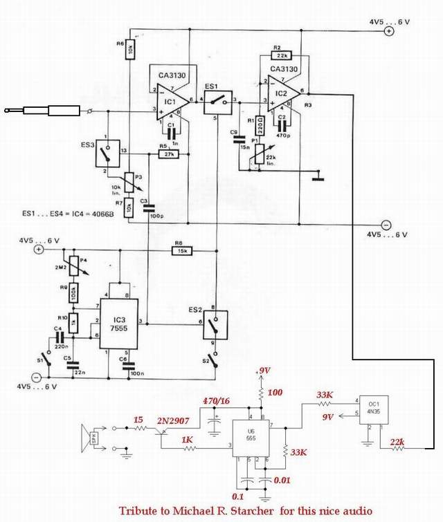

                        Cool !!! Now is working!
                        Now is working! I had to disconnect and try it again! It must be the Robert's big mouth about .ru sites. I gues, Robert "loudmouth" pissed some russian hacker and provoked him to "blast" here!??? Ha,ha,ha!
                        Anyway,i am very sorry for occupying so much space here, but i'll repeat here my last reply:
                        One more thing:
                        I am sorry, i absolute inadvertantly forgot to mention and also omited another, very
                        important alteration to my hand-made device !
                        "So this supposed to be only evasion from original schematic posted here."
                        This is not true, but i changed this stage from the begining, later just forgot to
                        mention here. Sorry again. Michael R. Starcher done a great job with this audio stage
                        in his "Homebrew PI" project!
                        I decided to use it with Zahori due to its great performances ! An it all worked nice
                        togather, from start!
                        Overall power consumption is so small, so one 9V battery could last a few days, i guess.
                        Although Esteban's "/comparator/timer/tone generator " is also good! And simillar to this.
                        It will take a much of testing on the field to establish right overview on those adjustments
                        included in design.Right now i am adjusting potentiometers on wild guess,so presets might
                        not be proper,therefore can not claim here anything for sure. We will see.
                        Deep in my hearth, i would like to share Esteban's optimism about Zahori's efficiency in
                        prospecting.
                        Only time will tell...
                        • #57
                          Schematic alteration...
                          Here is alteration of schematic...
                          • #58
                            Finall...
                            Finall redraw....
