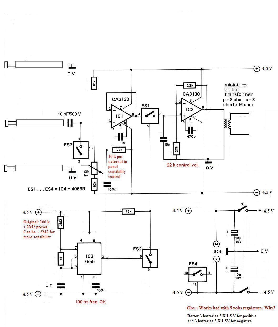

      • #33
        hi Esteban,
        Do you have the PCB layout for the zahori's project?
        may you send it to me in case you have it?
        thanks,
        miqui
        miquijacobo@hotmail.com

          • #35
            Hi All friends
            please try to use english.I am also not an english.but if you go on using mexico language I will learn it with your helps.
            for zahori ,in my opinion it works like a horizantal magnetometer.just gets the earth's magnetic field fluxes .does it have to take electstatic field.as a result of jump when crushed to diamagnetic materials(gold ,silver ,bronz) ,earth field density over ground increases and can be detected.this is my opinion.
            can you sent pictures of pcb pics and layouts of your modified zahori.
            I would like to try it.I want the one , you and your friend used.and you say these for
            Report? The only report I have of third part that found a gross heavy gold chain 1 m depth and 30 m far. Other person found antique woman comb carey and gold with gem stones, another found 4 gold coins, this same person found old wire for fences, entire roll! "
            thanks

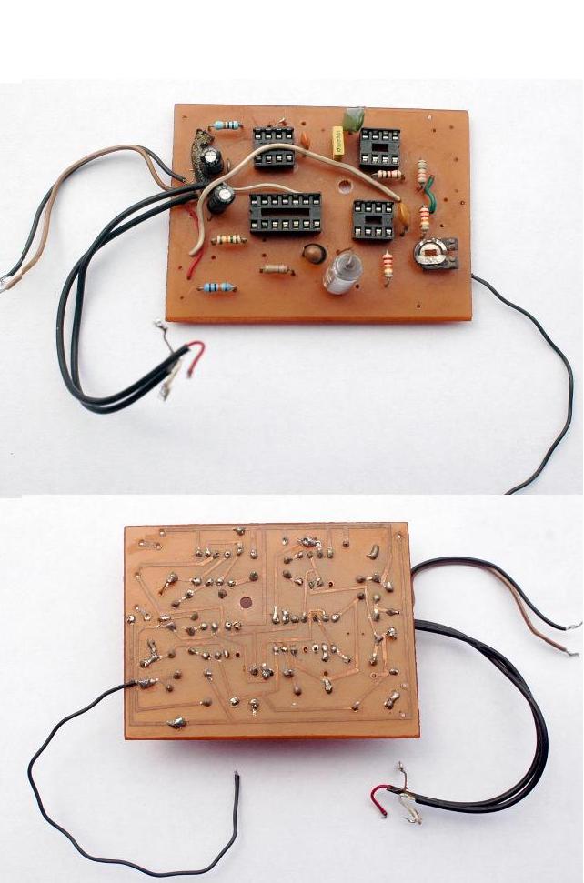

            • #36
              I wrote this:
              Yes, I built. In some part of my labo is the PCB, all with sockets. The PCB I make by own hand, no with PCB program, 10 years ago or more. I'll search and send here the photo.
              So, I don't have PCB, I'll post the photo of old project.
              Please, read and view all the pages and attachment of Zahori's thread.
              • #37
                Zahoir's PCB
                Originally posted by Esteban
                I wrote this:

                • #38
                  OK, mil gracias Miqui. De hecho, tengo el Express, es muy fácil de usar, bastante bueno... solo que no tengo tiempo para hacer el PCB. Muchas gracias por tu ayuda en este foro.
                  OK, thousands thanks Miqui. I use the Express, is easy to use, good program... but no time now for to design it. Thanks for your help in this forum.
                  • #39
                    My old Zahori
                    The old modified Zahori:

                              Hi Esteban
                              I am a newbee consructer.not an electronist.If I say something wrong please forgive me first.
                              I am confused of your last picture.in the picture you named "three antenna.pdf"there is something like meter.but in modified sch. nothing like that.
                              And in picture you sent last .there are two elctrolitic condansators like inold zahori's (which has 30a 70 cm plate antenna)battery unit.
                              Are photos from three antenna device you sent before or from an older one with plate antenna.
                              and for modified schamatic .it is not clear enough for me .is 0V antenna connected to one leg of IC4 or to S1,S2 swithces(at battery unit)
                              Are the founds you mentioned and you show in photos belong to this modified project or else.
                              Miqui congratulations,your layout is perfect.

                                Hi, the meter I don't use more, no important. The laterals antennas, the both, is connected in the middle of the batteries, this is, 0 V.
                                Yes, yu're right, in the modified schematic isn't the two capacitors. Go the correction here. This is the modified schematic, I never use plates, only antennas. If you want to try it... go ahead!
                                Yes the founds was with the modified, you have in the output of the transformer the necessary signal.
                                You must clean very well the PCB after solder.
