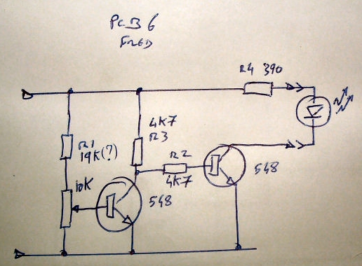

    I take out resistor and the measurement 18.09 (using 20kohm),so its something like 18k or 19k.
    I hope we discover all electronic mistery aroud this device...
    I think the puzzle of resistor is cause we read it at reverse:
    red,brown,red,black,gray,brown
    I think now it could be :
    brown, gray, black, red, brown, red
    That means:
    18000 ohm (like you measured) 1% (tolerance) 50ppm/°K
    What do you think ?
      So its 6 colours!
      Now its different,read backwards, using the calculator:
      It give 19 k 50PPM/ºC
      Now that´s a high precision resistor,you should be able to calibrate your tester with it!
      I think it's 18K cause if it's 1% (as probably is) the multimeter cannot read more or less than 18K +- 180ohm, so from 17820 to 18180 ohm:
      he reads a few above 18K (18.09K, so just about 90 ohm more) so it must be 18K.

        According to the colours given by Morgan, it's a 19k resistor. Where did you get the gray from?
          I suppose it's gray cause of value he measured... it's easy confusing gray with white on some kind of resistors ... colors can be not well defined or external protecting laquer can alter shine of bands.
          He measured 18.09K... so if resistor is really 1% tolerance it must be 18K nominal... otherwise the multimeter read a wrong value.
          • Yes Max,you are probably right :18 K if it´s grey.
            But in that case Morgan have to confirm if it´s grey,or white.Can be the multimeter too,or the hands .
              yes, true, I supposed he measured resistor without touching both leads with fingers... so just resistor value and not parallel with his body resistance.
              But I think he did right measure.

                  for me it's 18K cause probably white... is actually grey.
                  Am I wrong ?
                            hello
                            the colour is white,not grey.
                            I´m more worry with antenna and ferrite,why a simple resistor is so important...
                            This device works,and it will be very good if Esteban help us to build antenna,because i can´t dismantle this one...

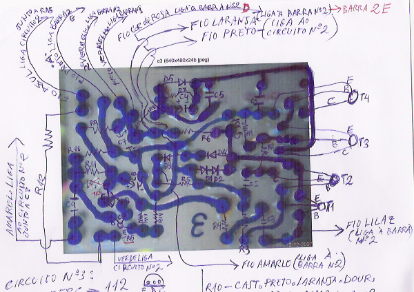

                            • Hi Morgan,
                              On PCB3 , lower left corner, i need to know transistors
                              numbers,and the component in // with R11.
                              Regards,
                              • Correction on PCB3
                                Hi Morgan,
                                Regards,
                                Sorry for some mystakes...
                                TR5-CBC548B
                                TR6-BC558CClick image for larger version
