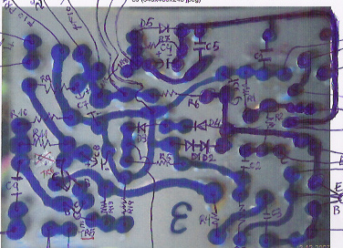

  • Correction on PCB 3

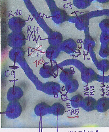

    Hi Morgan,
    On PCB3 , lower left corner, i need to know transistors
    numbers,and the component in // with R11.
    Regards,

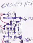

    • Circuit #5
      Here's circuit #5 - the one that connects to the ferrites.
      Morgan - Please can you double-check the component values, and in particular the component names. Your original diagram is difficult to read, and therefore some of the names (e.g. C3, C11, etc.) may be swapped over.
      The RED and BLACK wires are most likely the power supply lines, but where does YELLOW go to?
      Also, does anyone have any ideas about the correct connections for the ferrite coils? Morgan - if you can shed any light on this question, that would be great.

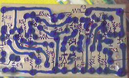

      • Better view PCB 1,2,3.
        Hi Morgan,
        Regards,

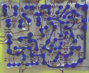

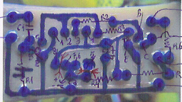

        • PCB 4,5,6.
          • Yelow cable
            The circuit 5,yellow wire connect with bar 2c.
            The cicuit 5, black´D` wire connect with bar 2G.
            The circuit 5,red wire connect with switch on-off,sensitivity.
            • Corrected!
                Hi Qiaozhi,
                I missed your post.
                This looks for sure like a simple DC receiver.So the gap could be making the frequency tunning, but as it is not a HV generator, i dont know if we can believe the gap story.
                regards,
                • Esteban schematic
                  Fortunly,Esteban say will have this Pistoldetektor schematic very soon

                            Corrected!
                            Hi Fred,
                            very nice work... now we know detectoman was right about this PCB. It's audio section... so have nothing to do with transmitter part.

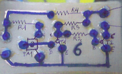

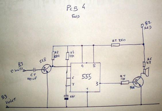

                                PCB6
                                73!
                                Ok... this seems really clear too.
                                It's threshold detector and led driver part as I guessed.
                                So if color is white we know now that it's 19K... then I think that resistor is that way (precision and low ppm/°K coeff) cause have to mantain threshold level at a knowing setting (turn) of trimpot (maybe to ease tuning of the circuit).
                                Also I strongly think that the low temp. coeff. is required to avoid thermal variations of threshold level (so have sense to me).
                                PS: from what I see it's kind of low battery alarm.
